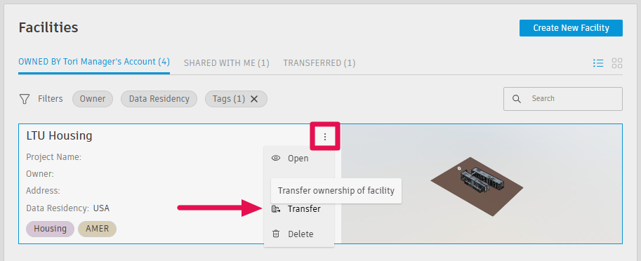

To get started from the Facilities page, under the facility menu, click transfer.
Before Continuing Please Note that when transferring facilities it is only possible to do so within the same region due to Data Residency restrictions. Facility regions cannot change once decided.

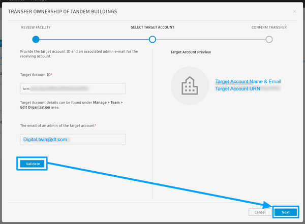

Select Target Account
For this step, the Target Account ID and the email address of one of the account admins is required. Once that information has been filled in, Click validate, and then Next.
Not sure where to find the Target Account information? Visit Tandem’s Organization Management page to learn where to find this information.

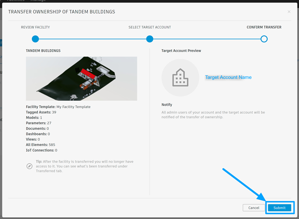

Confirm Transfer
Review the information. If everything is correct, click Submit.

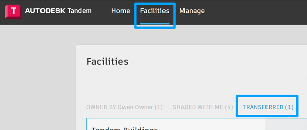

The transferred facility will appear in the Transferred section of the Facilities page.

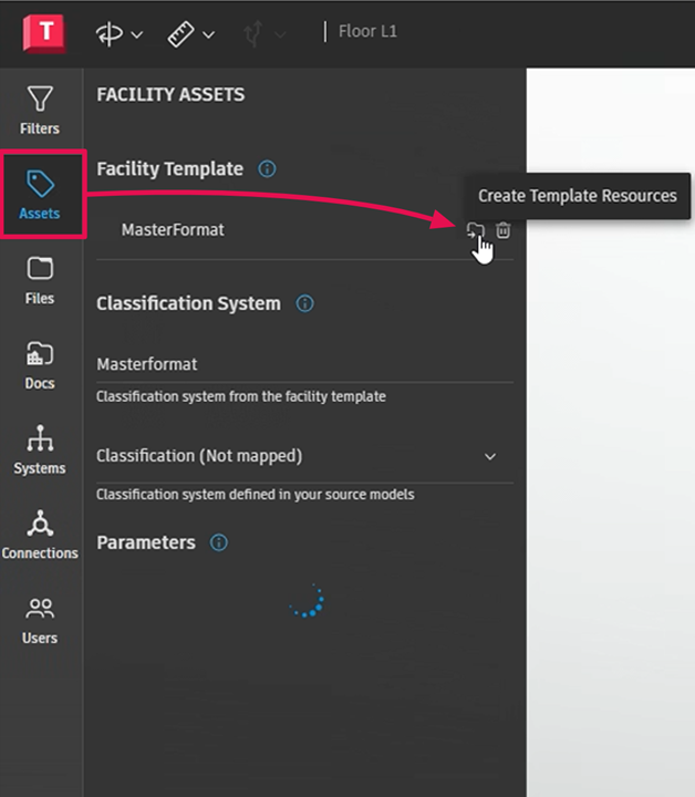

The receiving the account of the facility will need to set up their data structure. They can either use their own Facility Template or take advantage of what was sent with the facility. To take advantage of what was sent with the facility, start by opening and viewing the facility, and navigate to the assets tab to begin the Create Template Resources workflow.

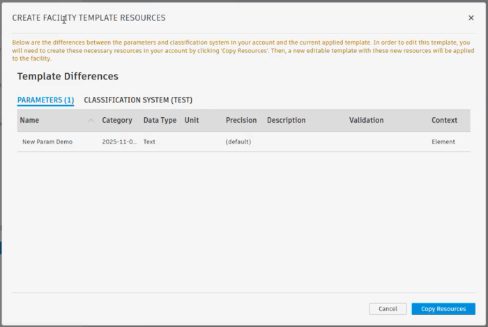

With the Create Template Resources dialogue box open, review the template differences. Once reviewed click Copy resources, to bring the elements from the data structure that are needed, into the Tandem account.
