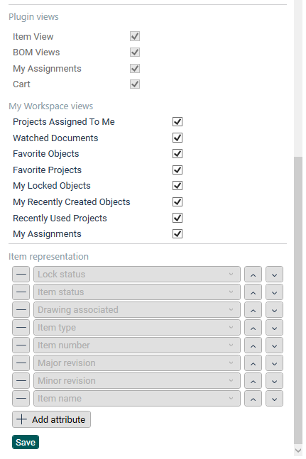

  • Change the CAD attribute mapping.
  • Configure Item View, BOM Views, My assignments, or Cart to not be displayed in the plugin.
  • Configure My Workspace to display or hide certain sections. Sections include Projects Assigned to Me, Watched Documents, Favorite Objects, Favorite Projects, My Locked Objects, My Recently Created Objects, Recently Used Projects, and My assignments.
  • View item representation settings (not currently configurable).
