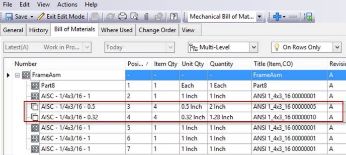

A grouped BOM row is a row that contains multiple occurrences of an item that share a single parent, but have one or more BOM row properties with different values. The different values for the BOM row properties can include, but are not limited to, Length, Quantity, and Description.
A grouped BOM row is indicated in the BOM by the Grouped icon.

When BOM rows are grouped together, only one row is displayed in the BOM. Unless otherwise specified, the values that are displayed represent the primary BOM row's properties.
Details
  • The Primary BOM row is the row with the Detail ID. If none of the rows in the group has a Detail ID, then another row is chosen as the primary row.
  • Position–This is the position of the group itself. If the rows are ungrouped, this value applies to all of the rows.
  • Row Order–This is the row order of the group itself. If the rows are ungrouped, this value applies to all of the rows.
  • Unit Qty–If the items in a BOM row group all share the same Unit of Measure type but the actual units are different, the value of the primary row is displayed in the Unit QTY field.
    Note: The Units QTY field is not displayed by default. You can add it to your BOMs by Customizing the BOM View.
  • Item QTY–The Item QTY value is the number of items in the group.
    Note: The Item QTY field is not displayed by default. You can add it to your BOMs by Customizing the BOM View.
  • Quantity–The Quantity value is the sum of all quantities in the group.
