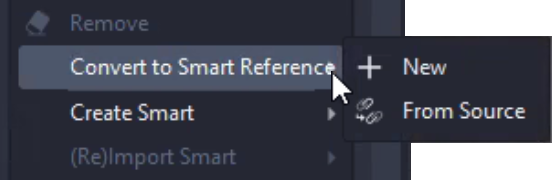

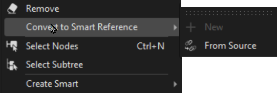

  • Convert to Smart Reference no longer overlaps the arrow in the Reference menu.
    2025 2025.2
    2025.1 Convert to Smart Reference example 2025.2 Convert to Smart Reference example

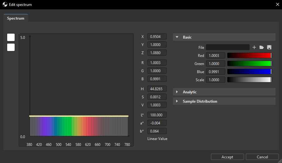

  • For Glass materials, Spectral Distribution for dispersion is editable. When Use Dispersion is enabled and Input Type is set to Spectral Distribution, click the IOR Spectrum option's Edit button. This opens a dialog for editing the spectral distribution.
    Spectral Distribution dialog
