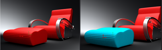

  • Cryptomatte: Added Cryptomatte support for creating masks during the rendering post-process.
    Cryptomatte Example
    For more information, check out the Cryptomatte Renderpass video.

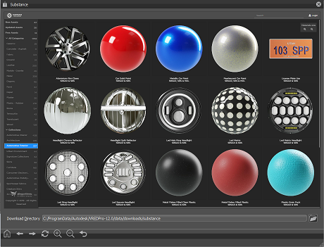

  • Web Shops: Log into a store, find a substance, then purchase and import the content into VRED.
    When the Substance Web Shop dialog is closed, you are still temporarily logged into the store.
    Substance Web Shop
    For more information, check out the Substance Web Shop video.
  • Web Shops Preference: Set the online store download path for the Substance Source Store.

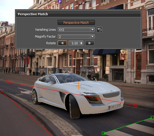

  • Perspective Camera Matching: Match the camera focal length and rotation matrix parameters to a backplate to integrate your model into the scene.
    Perspective Match
    For more information, check out the Camera Matching video.

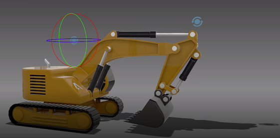

  • Improved Python functionality for constraints: Use vrConstraintService, as well as vrdConstraintNode, when working with constraints via Python.
    Python constraints
    For more information, check out the Python Constraints video.
