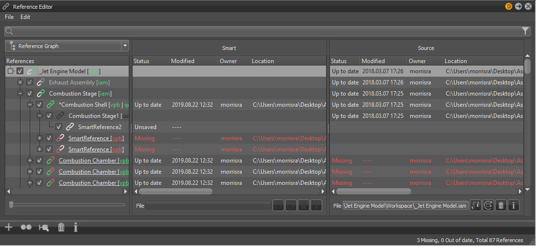

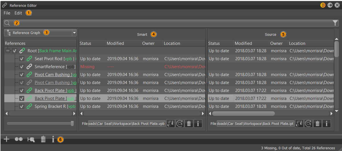

  • Reference Editor - Lists all reference nodes in your scene, identifying the kind of reference, file status, when something was last modified, who made the modifications, and the file location. All reference options, including (Re)Import, can be found in the menu bar or right-click context menu of the Reference Editor.
    Reference Editor
  • Reference Monitoring and Notifications - Improved the design and functionality of the Assembly/Reference update mechanism for monitoring changes and providing notifications.
    Monitoring and notifications

  • Reference Editor Edit functionality - Use the Edit menu for converting, reimporting, removing, deleting, and repathing references.
  • Reference File modification - Displays the location of the selected reference's source file. Use the File icons File icons to replace, reimport, delete, and get information for the selected reference.

  • Modified Reference Search Filtering - Added search filters to quickly find to what you need in the Reference Editor.

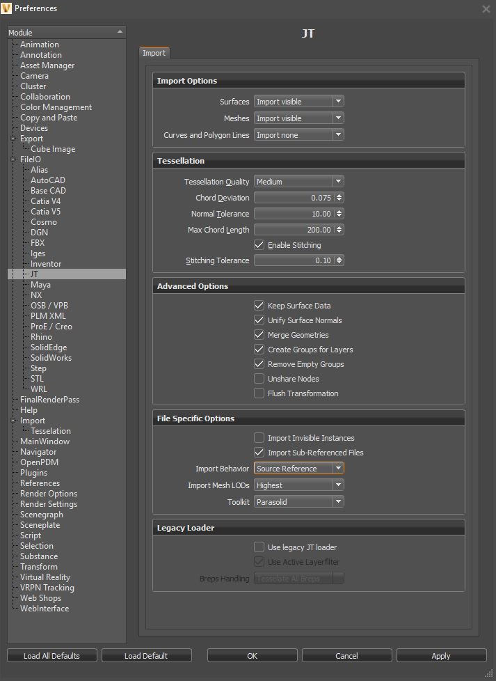

  • Toolkit - Added toolkit options to the import parameters and JT preferences for setting the toolkit used by VRED. Choose one of the following options: Parasolid or Jt Open (Experimental).
    Toolkit
