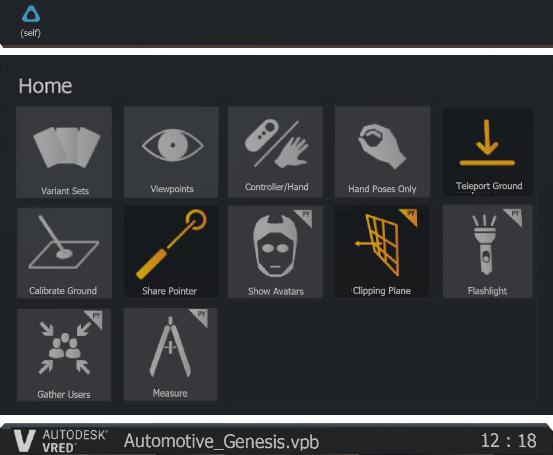

  • Collaboration Session Identification - Added Collaboration session participant icons and names to the top of the VR Menu Home Panel
  • Collaboration Session Clock - Added the time to the bottom of the VR Menu Home Panel

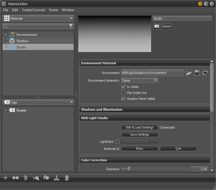

  • HDR Light Studio Quit button - Added a Quit button in the HDR Light Studio section, next to External UI, to shutdown an HDR Light Studio background process (HDRLightStudio.exe) and free up the license. Once all edits have been made in HDR Light Studio and the HDRI saved, click the Quit button to release the HDR Light Studio license for others to use.
    Quit button to free up an HDRLS license

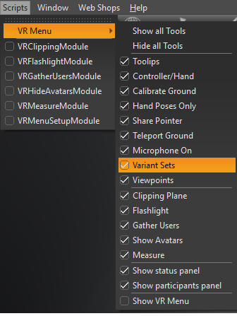

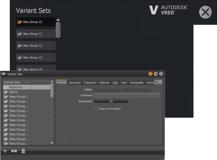

  • Variant Set Visibility - Added two ways to disable the visibility of Variant Sets in the VR Menu
    Variant Set visibility
    Removed from the VR Menu

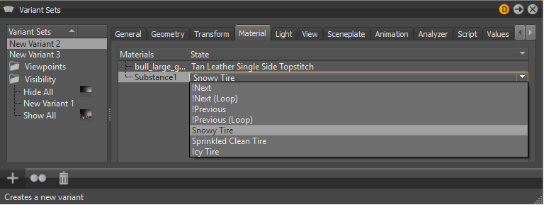

  • Substance presets - Made Substance presets and AxF sub-materials accessible in the Variants and VSets interface
    Substances in VSets module

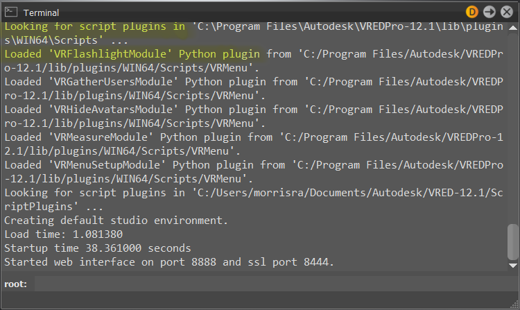

  • Scripting - Output loaded Script plugins in the Terminal to see which plugins are loaded and where, especially the new VR script plugins
    Output loaded script plugins in Terminal
