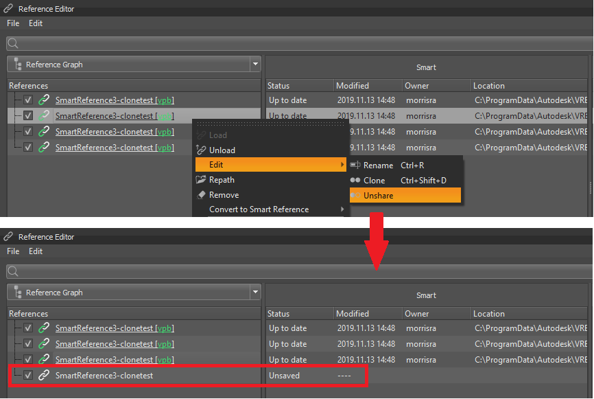

  • Referenced Clones - Improved working with cloned references. VRED now supports selective actions for cloned references. Use the Unshare option, found in the Reference Editor Edit context menu, to reset a cloned smart reference to an Unsaved status, breaking the cloning link, so actions can be applied to the newly changed unsaved smart references.
    Unsharing a cloned reference

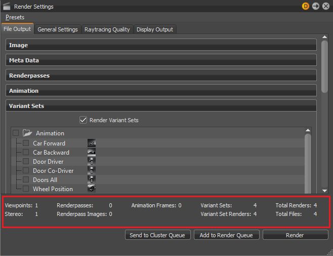

  • Render Summary - At the bottom of the Render Settings module, above the three buttons, you will find more information about what will be rendered, such as the total number of images and renders.

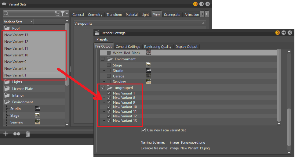

  • Ungrouped Variant Sets - When ungrouped variant sets are dragged from the Variant Sets module to the Variant Sets section of Render Settings, they will be grouped under the same parent node, named ungrouped. This treats all ungrouped nodes as if they belong to one group to simplify deleting, dragging and dropping, and selecting/deselecting.

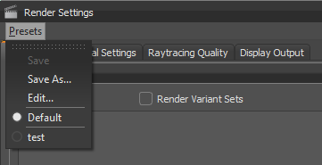

  • Preset Render Settings Menu - In Render Settings, click Presets to display a context menu for saving, reloading, editing, and restoring default rendering settings.

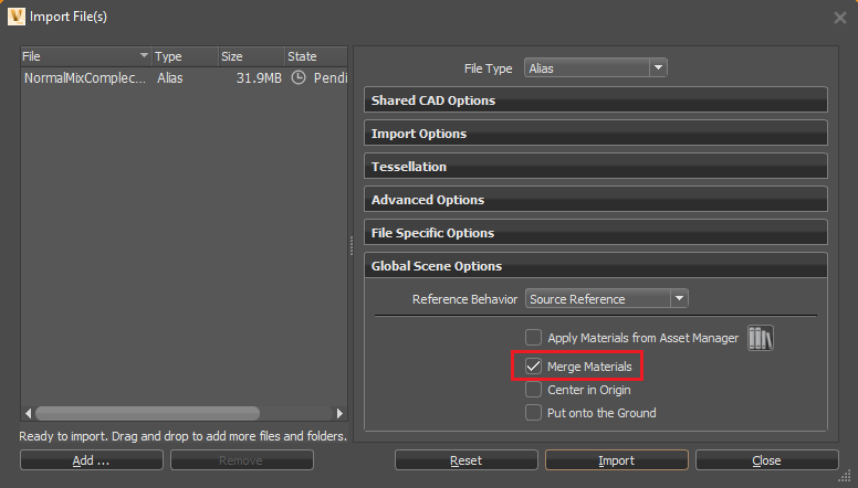

  • Merge Material - Added Merge Materials for CAD import to the Import File(s) dialog Global Scene Options.
    Merge Materials

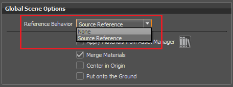

  • Reference Behavior drop-down - Moved the Reference Behavior drop-down menu from File Specific Options to Global Scene Options. Use the options to determine what happens to references upon import.
    Reference Behavior

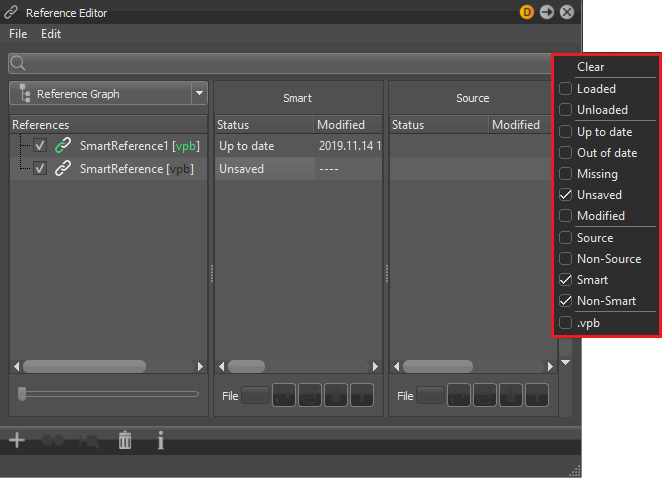

  • Non-smart and unsaved smart filters - Added options to the Reference Editor Filter to search for a source reference without a smart and for only unsaved smart references.

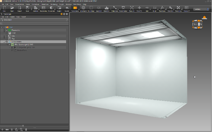

  • X-Rite SprectraLight QC - Added the X-Rite SpectraLight QC environment to the Asset Manager's Environment tab and installer.

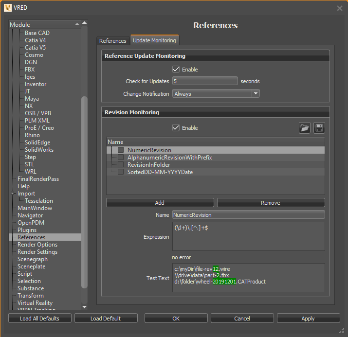

  • Regex - Added regex examples for changing the numeric, alphanumeric, and date revision numbers, as well as folder name structure used for revision monitoring.
    Changing Revisional Structure
