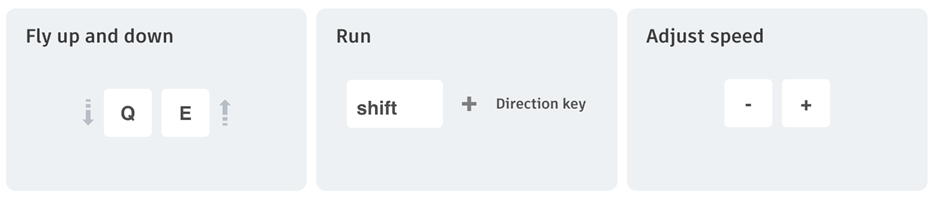

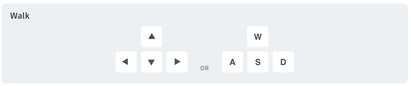

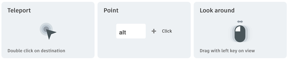

Autonomous Movement
Users can move freely inside a Workshop Web App without needing a VR headset or a VR host. Autonomous movement lets reviewers navigate models at their own pace.
Navigation with your keyboard:
"asd" "asd" "asd"

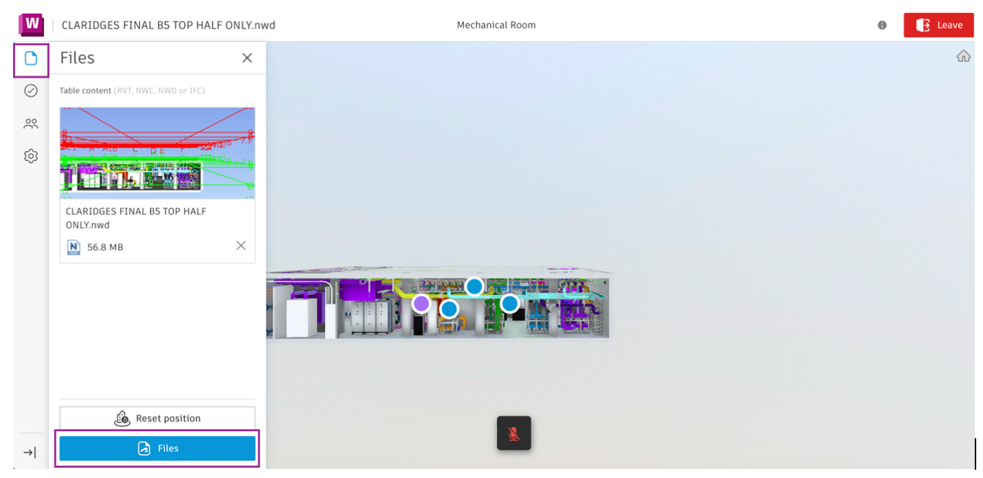

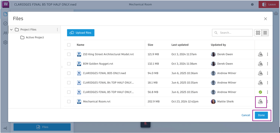

Share Files
Add or swap models without waiting for a headset user.
  1. Select Files on the left panel.
  2. Select the blue "Files" button. "asd"
  3. Click model icon to share new file to the table.
  4. Press "Done".

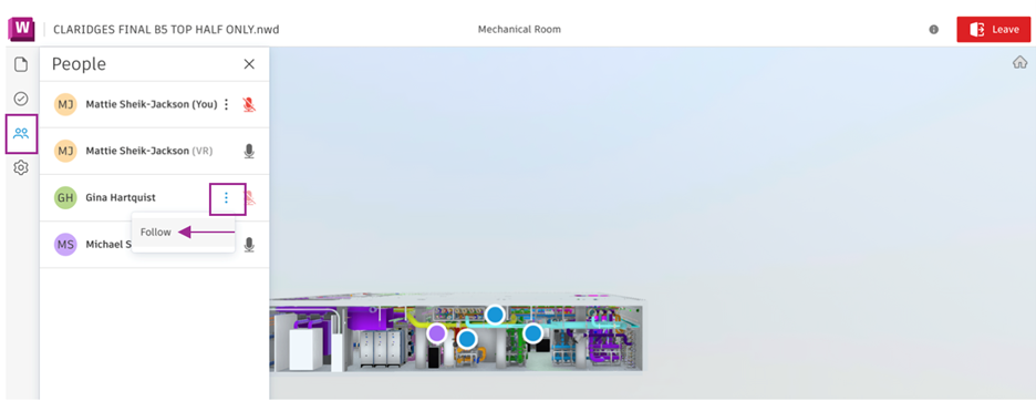

Follow
Users can choose who to follow during the design review.
  1. Click the People panel.
  2. Click the three dots next to the user you wish to follow.
  3. Click “follow”.
  4. Once following, autonomous movement is no longer available. Users will not be able to look around and the point of view is locked to the user being followed.

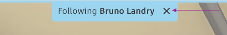

To unfollow:
  • The user being followed will be listed at the top of the page and you can unfollow. "asd"
  • Or select unfollow in the people menu—same as how the user followed.

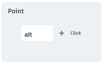

Pointing
Web and VR users can both point in the model to highlight areas of interest. The name of the participant pointing will appear next to the laser point for other users to see.
