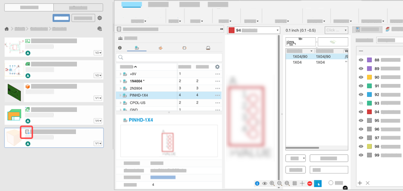

Fusion Electronics Library
Figure 1: Hub Electronics library document opened from the project folder in the data panel.

Hub libraries
If you want to edit a symbol, footprint, or package you must create a hub library in which to store them and edit them. You can create new components in a hub library and import components from other libraries. Hub library documents that you use in your design can be easily opened from your project folder in the data panel.
