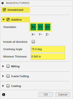

Specify the Unrestricted and Additive manufacturing methods for the generative study, then set the Overhang Angle to 70 deg and the Minimum Thickness to 0.045 in.
- On the Define tab, click Design Criteria > Manufacturing
. - In the Manufacturing dialog, ensure that the Unrestricted and Additive methods are selected, and deselect any other manufacturing methods.
Note: The application creates two different types of the outcomes, without and with the additive manufacturing constraints specified below. - Click X+, Y+, and Z+ buttons to set the 3D printing build direction for additive.
- In the Overhang Angle field, enter 70.
- In the Minimum Thickness field, enter 0.045.
- Click OK.
