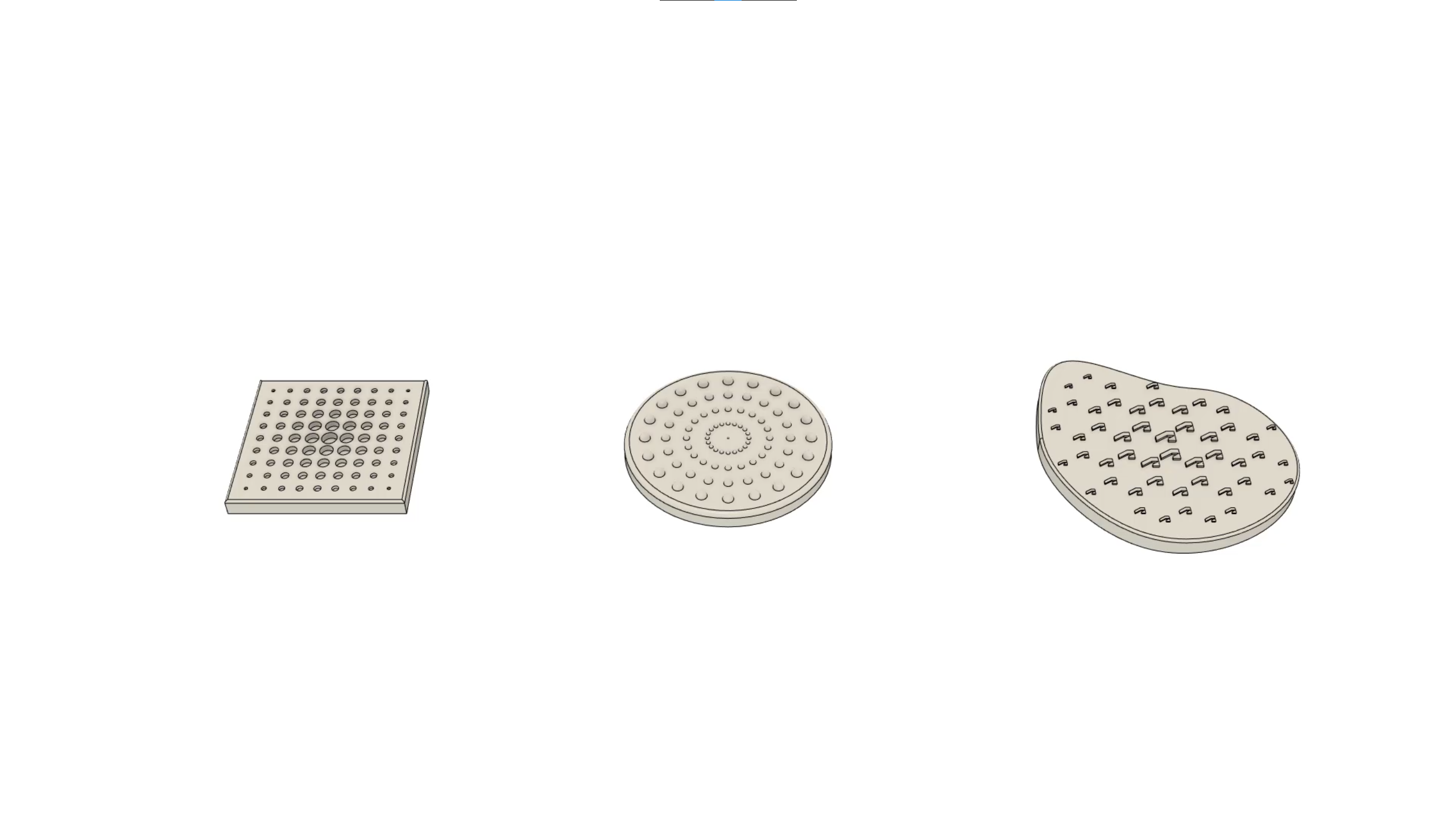

Create a geometric pattern
Learn how to use the Geometric Pattern tool to create a pattern with size and distribution gradients across a face on a solid body in Fusion.

The Geometric Pattern displays on the selected faces on the solid body in the canvas.
Tips
  • Adjust the size limits and spread to control the gradient across the pattern.
  • Adjust the Operation to Cut material away from the existing body, Join material to it, Intersect the bodies to keep only the material that overlaps, or create New Bodies in the design.
