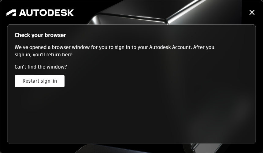

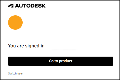

Sign In After Installation
After you have Installed Desktop Connector, you will automatically be asked to sign in as part of the start-up process. Simply enter your Autodesk credentials to start working with Desktop Connector.
A Connector is created in File Explorer for each supported data source associated with your Autodesk credentials.
Sign In After Sign Out

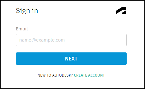

If you've previously signed out, click the tray icon and the home screen will prompt you to sign back in.
- Click
- Enter your Autodesk credentials.
Alternatively, you can right-click the tray icon and select .
