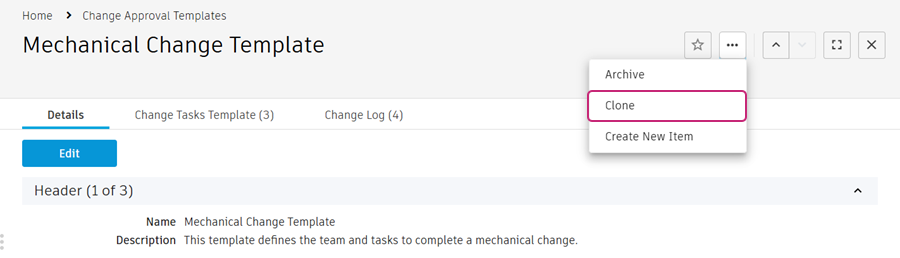

  1. Open the menu and select Workspaces > Change Management > Change Approval Templates.
  2. Select the existing Mechanical Change Template that was created in Activity 1.
  3. Click the three dot menu and select Clone.
    clone

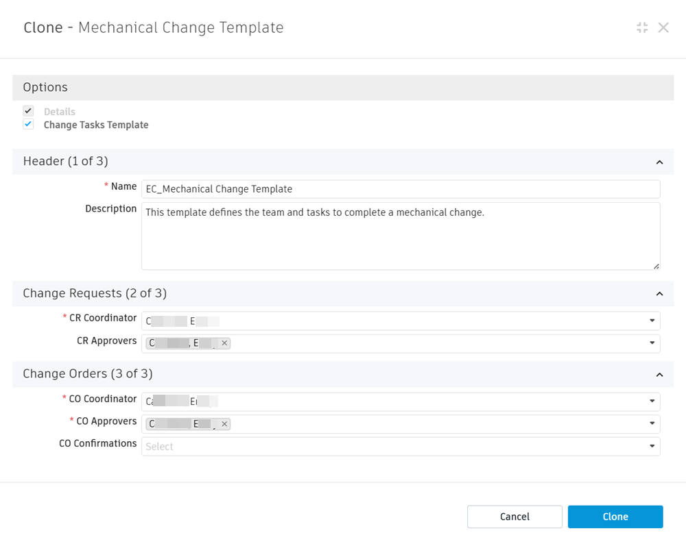

  4. Rename the template to include your initials as a prefix.
  5. In the Change Requests section, select yourself as the CR Coordinator and CR Approver.
  6. In the Change Orders section, select yourself as the CO Coordinator and CO Approver.
    clone information
  7. Click Clone.
