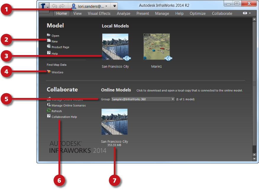

Models are collections of information, styles, and data. You interact with models on the Start page.
  1. Sign in.
  2. Use links to open or create a model, or to see information about Autodesk InfraWorks.
  3. Click a local model to open it.
  4. Connect to the InfraWorks data catalog on WeoGeo.com.
  5. Change your current group to see associated online models.
  6. Use links to see all online models, manage online scenarios, or to see information about Autodesk InfraWorks 360.
  7. Click an online model to download and open it.
The Start page appears when you start InfraWorks. To redisplay it after opening or creating a model, close the current model.
