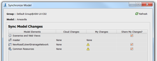

You include a scenario in a sync by selecting the Share My Changes checkbox for Scenarios and Web Views on the Synchronise Model panel. See also To synchronise models.

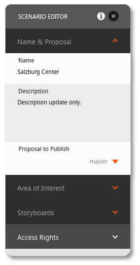

To Open the Scenario Editor:
  1. Open the model; work in the master or switch the view to a proposal. Scenario definition requires setting the Area of Interest in the target proposal or model.
  2. Click to open the Scenario Browser.
  3. Click to open the Scenario Editor for a new scenario.
    Double-click an existing scenario to open it in the Editor.
To Define a scenario:
Click inside a section of the Scenario Editor to expand it.
  1. Supply two required values and optional ones to complete the definition:
  2. Click to sync the model.
