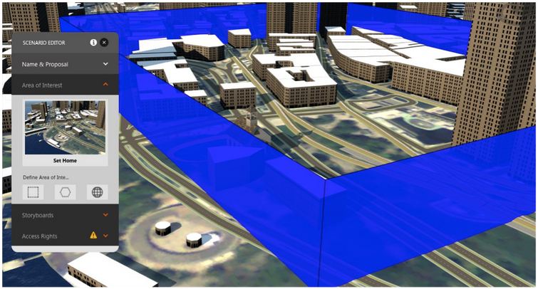

To define a scenario Area of Interest and Home Position
Scenarios often focus on a portion of a larger model. Define an Area of Interest in a scenario to speed-up processing and focus a viewer's attention.
  1. Open the model.
  2. Click to open the Scenario Browser.
  3. Click to open the Scenario Editor for a new scenario.
  4. On the Scenario Editor asset card, click Area of Interest.
  5. Select type of point identification box: rectangle, polygon, or entire model.
    Use entire model with caution, especially for large models.
  6. Draw area of interest, double-click to finish operation.
    To cancel operation, press Esc twice; once to de-select, second time to display Scenario Browser.
Set Home position
Viewers can always return to Home Position view after navigating scenario.
  1. Click Set Home.
  2. Zoom and pan to desired position, press Enter.
    To cancel, press Esc.
