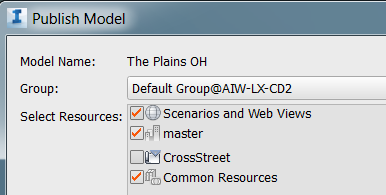

Once published, a scenario is part of its model. Users share changes to a scenario by syncing the model containing its scenarios. However, publishing a model or syncing changes to a model doesn't automatically include sharing changes to its scenarios. You control when to include a model's scenarios (or Web Views) when first publishing the model or when syncing.
