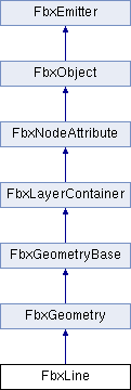

Inheritance diagram for FbxLine:Public Member Functions | |
