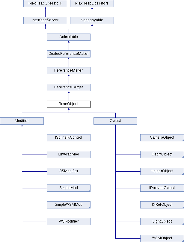

Class Description
This is the base class for objects and modifiers.
Anything with a representation in the 3D viewports is derived from BaseObject (including modifiers and controllers whose gizmos appear in the viewports). The methods here are things such as displaying the object in the viewports, checking for intersection of the object and points the user clicks with the mouse, snapping to the object, and computing various bounding boxes for the object. Also there are methods for returning the name of the object to appear in the modifier stack, a method to deal with creating the object in the viewports (if appropriate), and named selection set related methods. There are also methods that allow other plug-ins to access the changeable parameters of the object. Finally there are several method that deal with sub-object selection, sub-object display, sub-object hit testing, and moving/rotating/scaling sub-object components of the object.
See Also
Class ReferenceTarget, Class INode, Class ViewExp, Class Box3, Class IPoint2
Class Matrix3, Structure SnapInfo, Class Point3, Class CreateMouseCallBack
Template Class Tab, Class Interface.
+ Inheritance diagram for BaseObject:
