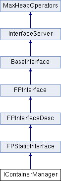

+ Inheritance diagram for IContainerManager:
