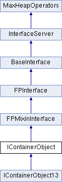

+ Inheritance diagram for IContainerObject:
