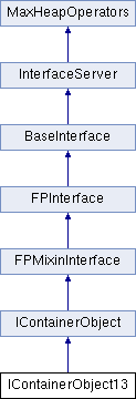

IContainer13 Interface.
IContainer13 extends container object functionality. In particular it provides support for new access rules that inherited containers may follow.
Previously, containers would only allow for no access when inherited or access to edit in place so that a user can save over the original definition. Now in addition a container can grant access to only add new objects over the inherited container or get full freedom to access anything that was unlocked on the original source definition. For the latter case the user can specify additional locks over certain items, such as all materials, all modifiers, all transforms or all objects, to restrict what's accessible further.
