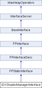

+ Inheritance diagram for IDXShaderManagerInterface:
