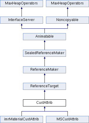

+ Inheritance diagram for CustAttrib:

Member Function Documentation
virtual SClass_ID SuperClassID ( )
inlinevirtual
Retrieves a constant representing the type of the plugin.
Returns
A super class id that uniquely identifies the type (category) of the plugin. Note that several plugin classes can be of the same type, thus return the same super class id. Plugins are uniquely identified by their class ids. List of Super Class IDs.
See Also
SClass_ID
Reimplemented from ReferenceTarget.
Reimplemented in MSCustAttrib.
34 { return CUST_ATTRIB_CLASS_ID; }
