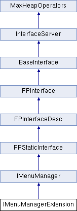

Inheritance diagram for IMenuManagerExtension:Public Member Functions | |
