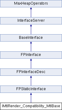

IMtlRender_Compatibility_MtlBase Class Reference
IMtlRender_Compatibility_MtlBase Class Referenceabstract

+ Inheritance diagram for IMtlRender_Compatibility_MtlBase:
