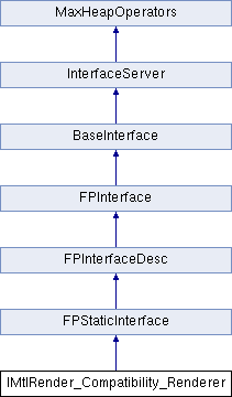

+ Inheritance diagram for IMtlRender_Compatibility_Renderer:
