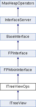

This class contains the operations you can do on any open trackview.
+ Inheritance diagram for ITreeViewOps:
