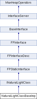

NaturalLightClassBaseImp Class Reference
#include <naturalLight.h>
+ Inheritance diagram for NaturalLightClassBaseImp:
