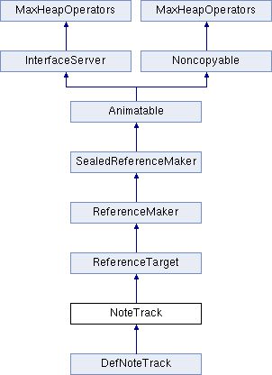

#include <notetrck.h>
Inheritance diagram for NoteTrack:Public Member Functions | |
