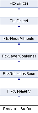

+ Inheritance diagram for FbxNurbsSurface:
