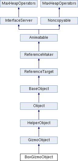

#include <gizmoimp.h>
Inheritance diagram for BoxGizmoObject:Public Member Functions | |
| CoreExport | BoxGizmoObject () |
