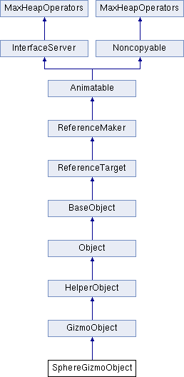

+ Inheritance diagram for SphereGizmoObject:
