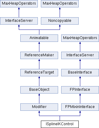

| | FN_0 (getHelperCount, TYPE_INT, GetHelperCount) |
| | FN_0 (getKnotCount, TYPE_INT, GetKnotCount) |
| | FN_0 (link_allToRoot, TYPE_BOOL, LinkToRoot) |
| | FN_0 (link_allinHierarchy, TYPE_BOOL, LinkInHierarchy) |
| | FN_0 (link_none, TYPE_BOOL, UnLink) |
| | FN_1 (create_hlpr, TYPE_BOOL, CreateHelpers, TYPE_INT) |
| FPInterfaceDesc * | GetDesc () |
| virtual int | GetHelperCount ()=0 |
| virtual int | GetKnotCount ()=0 |
| virtual BOOL | LinkToRoot ()=0 |
| virtual BOOL | LinkInHierarchy ()=0 |
| virtual BOOL | UnLink ()=0 |
| virtual BOOL | CreateHelpers (int knotCt)=0 |
