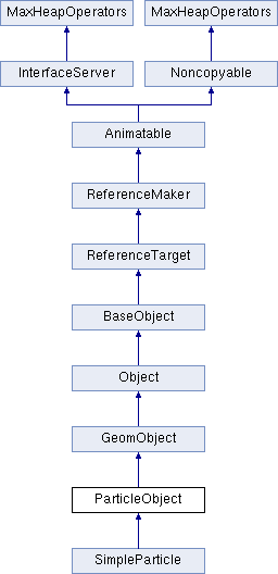

#include <object.h>
This is the base class for creating particle system plug-ins.
Many particle systems may be derived from class SimpleParticle instead of this class. See Class SimpleParticle for more details. Note: This class is derived from GeomObject and still has GEOMOBJECT_CLASS_ID as its super class. To determine if an object is a ParticleObject, call: Animatable::GetInterface() with the ID I_PARTICLEOBJ or use the macro: GetParticleInterface(anim) where anim is the object in question. This will return a ParticleObject* or NULL. See Class Animatable . Note: See the method Animatable::GetProperty() for details on choosing the method used to evaluate the particle system during motion blur rendering.
Inheritance diagram for ParticleObject:Public Member Functions | |
