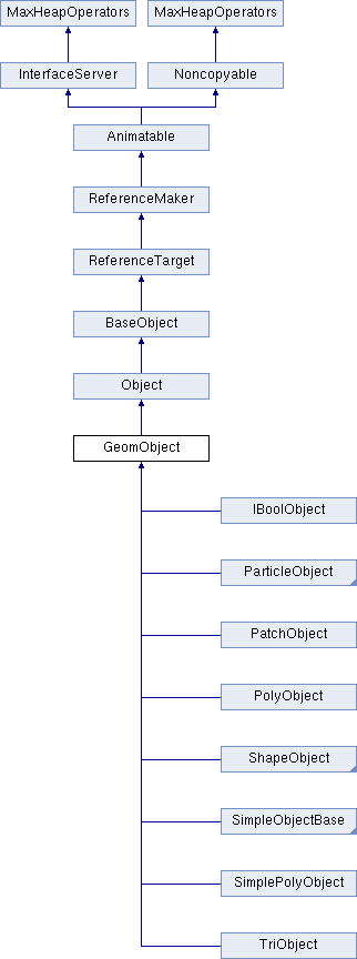

Inheritance diagram for GeomObject:Public Member Functions | |
