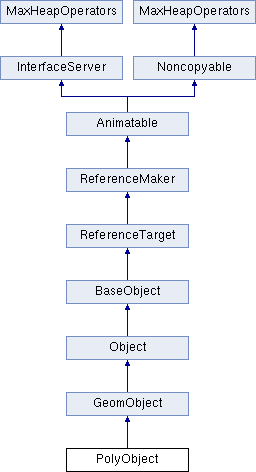

| PolyLibExport | PolyObject () |
| PolyLibExport | ~PolyObject () |
| virtual PolyLibExport bool | PrepareDisplay (const MaxSDK::Graphics::UpdateDisplayContext &prepareDisplayContext) |
| virtual PolyLibExport bool | UpdatePerNodeItems (const MaxSDK::Graphics::UpdateDisplayContext &updateDisplayContext, MaxSDK::Graphics::UpdateNodeContext &nodeContext, MaxSDK::Graphics::IRenderItemContainer &targetRenderItemContainer) |
| virtual PolyLibExport unsigned long | GetObjectDisplayRequirement () const |
| PolyLibExport int | HitTest (TimeValue t, INode *inode, int type, int crossing, int flags, IPoint2 *p, ViewExp *vpt) |
| | This method is called to determine if the specified screen point intersects the item. More...
| PolyLibExport int | Display (TimeValue t, INode *inode, ViewExp *vpt, int flags) |
| | This is called by the system to have the item display itself (perform a quick render in viewport, using the current TM). More...
| PolyLibExport void | Snap (TimeValue t, INode *inode, SnapInfo *snap, IPoint2 *p, ViewExp *vpt) |
| | Checks the point passed for a snap and updates the SnapInfo structure. More...
| PolyLibExport CreateMouseCallBack * | GetCreateMouseCallBack () |
| | This method allows the system to retrieve a callback object used in creating an object in the 3D viewports. More...
| PolyLibExport RefTargetHandle | Clone (RemapDir &remap) |
| | This method is used by 3ds Max to clone an object. More...
| PolyLibExport ObjectState | Eval (TimeValue time) |
| | This method is called to evaluate the object and return the result as an ObjectState. More...
| PolyLibExport Interval | ObjectValidity (TimeValue t) |
| | This method returns the validity interval of the object as a whole at the specified time. More...
| PolyLibExport BOOL | HasUVW () |
| | Call this method to find out if the object has UVW coordinates. More...
| PolyLibExport BOOL | HasUVW (int mapChannel) |
| | Call this method to find out if the object is has UVW coordinates for the specified mapping channel. More...
| PolyLibExport Object * | CollapseObject () |
| | This method is called on the world space cache object when the stack gets collapsed, that lets the pipeline object decide, if it wants to return a different object than itself. More...
| PolyLibExport Interval | ChannelValidity (TimeValue t, int nchan) |
| | Retrieve the current validity interval for the nchan channel of the object. More...
| PolyLibExport Interval | PartValidity (ChannelMask channels) |
| PolyLibExport void | SetChannelValidity (int i, Interval v) |
| | Sets the validity interval of the specified channel. More...
| PolyLibExport void | SetPartValidity (ChannelMask channels, Interval v) |
| PolyLibExport void | InvalidateChannels (ChannelMask channels) |
| | This method invalidates the intervals for the given channel mask. More...
| PolyLibExport Interval | ConvertValidity (TimeValue t) |
| int | IsDeformable () |
| | Indicates whether this object is deformable. More...
| PolyLibExport int | NumPoints () |
| | The points of a deformable object are accessed through a virtual array interface. More...
| PolyLibExport Point3 | GetPoint (int i) |
| PolyLibExport void | SetPoint (int i, const Point3 &p) |
| PolyLibExport void | PointsWereChanged () |
| | Informs the object that its points have been deformed, so it can invalidate its cache. More...
| PolyLibExport void | Deform (Deformer *defProc, int useSel=0) |
| | This is the method used to deform the object with a deformer. More...
| BOOL | IsPointSelected (int i) |
| float | PointSelection (int i) |
| BOOL | PolygonCount (TimeValue t, int &numFaces, int &numVerts) |
| int | IsMappable () |
| | This method lets you know if the ApplyUVWMap() method is available for this object. More...
| int | NumMapChannels () |
| | Returns the maximum number of channels supported by this type of object. More...
| int | NumMapsUsed () |
| | Returns the number of maps currently used by this object. More...
| PolyLibExport void | ApplyUVWMap (int type, float utile, float vtile, float wtile, int uflip, int vflip, int wflip, int cap, const Matrix3 &tm, int channel=1) |
| | This method may be called to map the object with UVW mapping coordinates. More...
| PolyLibExport void | GetDeformBBox (TimeValue t, Box3 &box, Matrix3 *tm=NULL, BOOL useSel=FALSE) |
| | This method computes the bounding box in the objects local coordinates or the optional space defined by tm. More...
| PolyLibExport int | CanConvertToType (Class_ID obtype) |
| | Indicates whether the object can be converted to the specified type. More...
| PolyLibExport Object * | ConvertToType (TimeValue t, Class_ID obtype) |
| | This method converts this object to the type specified and returns a pointer it. More...
| PolyLibExport void | FreeChannels (ChannelMask chan) |
| | This method deletes the memory associated with the specified channels and set the intervals associated with the channels to invalid (empty). More...
| PolyLibExport Object * | MakeShallowCopy (ChannelMask channels) |
| | This method must make a copy of its "shell" and then shallow copy (see below) only the specified channels. More...
| PolyLibExport void | ShallowCopy (Object *fromOb, ChannelMask channels) |
| | This method copies the specified channels from the fromOb to this and copies the validity intervals. More...
| PolyLibExport void | NewAndCopyChannels (ChannelMask channels) |
| | This method replaces the locked channels with newly allocated copies. More...
| PolyLibExport DWORD | GetSubselState () |
| PolyLibExport void | SetSubSelState (DWORD s) |
| PolyLibExport BOOL | CheckObjectIntegrity () |
| PolyLibExport int | IntersectRay (TimeValue t, Ray &ray, float &at, Point3 &norm) |
| | This method is called to compute the intersection point and surface normal at this intersection point of the ray passed and the object. More...
| PolyLibExport void | GetWorldBoundBox (TimeValue t, INode *inode, ViewExp *vpt, Box3 &box) |
| | This method returns the world space bounding box for Objects (see below for the Sub-object gizmo or Modifiers gizmo version). More...
| PolyLibExport void | GetLocalBoundBox (TimeValue t, INode *inode, ViewExp *vpt, Box3 &box) |
| | This is the object space bounding box, the box in the object's local coordinates. More...
| PolyLibExport Mesh * | GetRenderMesh (TimeValue t, INode *inode, View &view, BOOL &needDelete) |
| | This method should be implemented by all renderable GeomObjects. More...
| PolyLibExport void | TopologyChanged () |
| PolyLibExport void | CheckMesh (INode *inode) |
| MNMesh & | GetMesh () |
| PolyLibExport void | DeleteThis () |
| | Deletes an instance of this class. More...
| void | FreeCaches () |
| Class_ID | ClassID () |
| | Retrieves a constant that uniquely identifies the plugin class. More...
| void | GetClassName (MSTR &s) |
| | Retrieves the (localizable) name of the plugin class. More...
| void | NotifyMe (Animatable *subAnim, int message) |
| int | IsKeyable () |
| int | Update (TimeValue t) |
| const MCHAR * | GetObjectName () |
| PolyLibExport void | RescaleWorldUnits (float f) |
| | Rescale size of all world units in reference hierarchy. More...
| PolyLibExport IOResult | Save (ISave *isave) |
| | Called for saving data. More...
| PolyLibExport IOResult | Load (ILoad *iload) |
| | Called for loading data. More...
| PolyLibExport BOOL | CanDoDisplacementMapping () |
| PolyLibExport void | SetDisplacementApproxToPreset (int preset, bool notifyDependents=true) |
| void | SetDisplacementDisable (bool disable) |
| void | SetDisplacementParameters (TessApprox ¶ms) |
| void | SetDisplacementSplit (bool split) |
| void | SetDisplacement (bool displace) |
| bool | GetDisplacementDisable () const |
| TessApprox | GetDisplacementParameters () const |
| bool | GetDisplacementSplit () const |
| bool | GetDisplacement () const |
| TessApprox & | DispParams () |
| PolyLibExport void | ReduceDisplayCaches () |
| | Should reduce any derived display data to save memory, since the node wont be drawn until the user undhides it. More...
| PolyLibExport bool | NeedGWCacheRebuilt (GraphicsWindow *gw, Material *ma, int numMat) |
| | This returns whether the Graphics Cache for this object needs to be rebuilt. More...
| PolyLibExport void | BuildGWCache (GraphicsWindow *gw, Material *ma, int numMat, BOOL threaded) |
| | This builds the graphics window cached mesh. More...
| virtual void | InitNodeName (MSTR &s) |
| | This is the default name of the node when it is created. More...
| SClass_ID | SuperClassID () |
| | Retrieves a constant representing the type of the plugin. More...
| virtual int | IsRenderable () |
| | Indicates whether the object may be rendered. More...
| virtual int | IsInstanceDependent () |
| | If an object creates different meshes depending on the particular instance (view-dependent) it should return nonzero; otherwise 0. More...
| virtual int | NumberOfRenderMeshes () |
| | Objects may supply multiple render meshes ( e.g. More...
| virtual Mesh * | GetMultipleRenderMesh (TimeValue t, INode *inode, View &view, BOOL &needDelete, int meshNumber) |
| | For multiple render meshes, this method must be implemented. More...
| virtual void | GetMultipleRenderMeshTM (TimeValue t, INode *inode, View &view, int meshNumber, Matrix3 &meshTM, Interval &meshTMValid) |
| virtual CoreExport PatchMesh * | GetRenderPatchMesh (TimeValue t, INode *inode, View &view, BOOL &needDelete) |
| | This method provides a patch mesh representation of the object for use by the renderer. More...
| CoreExport Class_ID | PreferredCollapseType () |
| | This method allows objects to specify the class that is the best class to convert to when the user collapses the stack. More...
| CoreExport | Object () |
| CoreExport | ~Object () |
| virtual int | UsesWireColor () |
| | This method determines if the object color is used for display. More...
| virtual int | DoOwnSelectHilite () |
| | If an object wants to draw itself in the 3D viewports in its selected state in some custom manner this method should return nonzero. More...
| virtual BOOL | NormalAlignVector (TimeValue t, Point3 &pt, Point3 &norm) |
| | Objects that don't support the IntersectRay() method (such as helper objects) can implement this method to provide a default vector for use with the normal align command in 3ds Max. More...
| void | LockObject () |
| | Implemented by the System. More...
| void | UnlockObject () |
| int | IsObjectLocked () |
| void | LockChannels (ChannelMask channels) |
| void | UnlockChannels (ChannelMask channels) |
| ChannelMask | GetChannelLocks () |
| void | SetChannelLocks (ChannelMask channels) |
| ChannelMask | GetChannelLocks (ChannelMask m) |
| virtual BOOL | CanCacheObject () |
| | This method determines if this object can have channels cached. More...
| virtual void | WSStateInvalidate () |
| | This is called by a node when the node's world space state has become invalid. More...
| virtual BOOL | IsWorldSpaceObject () |
| | Returns TRUE if the object as a world space object; otherwise FALSE. More...
| CoreExport INode * | GetWorldSpaceObjectNode () |
| virtual BOOL | IsParticleSystem () |
