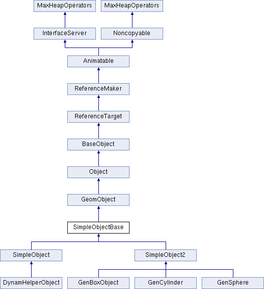

Procedural Object plug-ins which subclass off SimpleObjectBase must implement these methods. The default implementations are noted.
+ Inheritance diagram for SimpleObjectBase:
