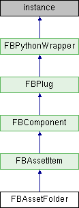

+ Inheritance diagram for FBAssetFolder:
