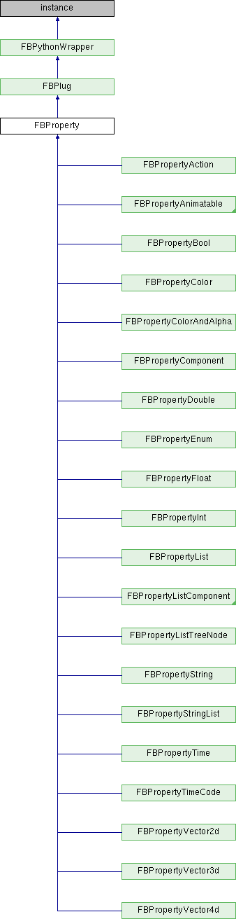

Inheritance diagram for FBProperty:Public Member Functions | |
