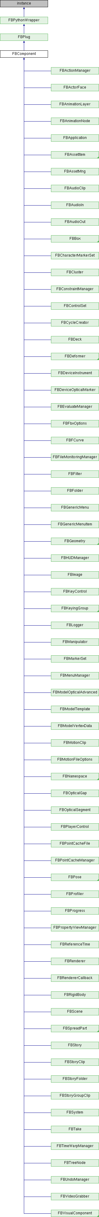

FBComponent defines common object characteristics, including creation and destruction methods. It is used to encapsulate internal application objects so they can be exposed to the SDK. It is also used as the base class to encapsulate objects with FBProperty data members and provides a scheme for property management. You cannot instantiate FBProperty objects. To reference a property, use an instance of an FBComponent object. The methods FBComponent::PropertyCreate and FBComponent::PropertyRemove can be used to modify an object's properties. Basic operators are overloaded in FBComponent. The constructor and destructor are created and defined with macros in the header files. Objects inheriting from FBComponent must define FBComponent::FBCreate(), and FBComponent::FBDestroy(). All memory management issues for the component should also be addressed here. Destroy an object with FBDelete(). The code sample FBComponent.py shows how to get a handle on a scene object via its name.
Inheritance diagram for FBComponent:Public Member Functions | |
