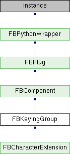

+ Inheritance diagram for FBKeyingGroup:
