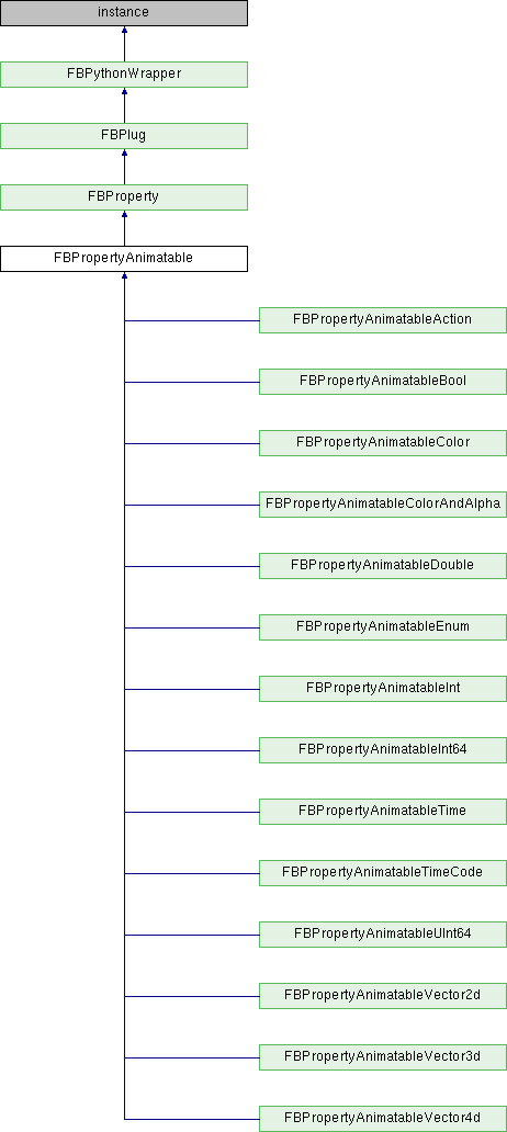

Inheritance diagram for FBPropertyAnimatable:Public Member Functions | |
