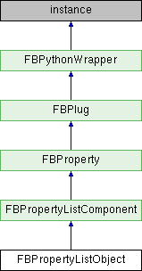

+ Inheritance diagram for FBPropertyListObject:
