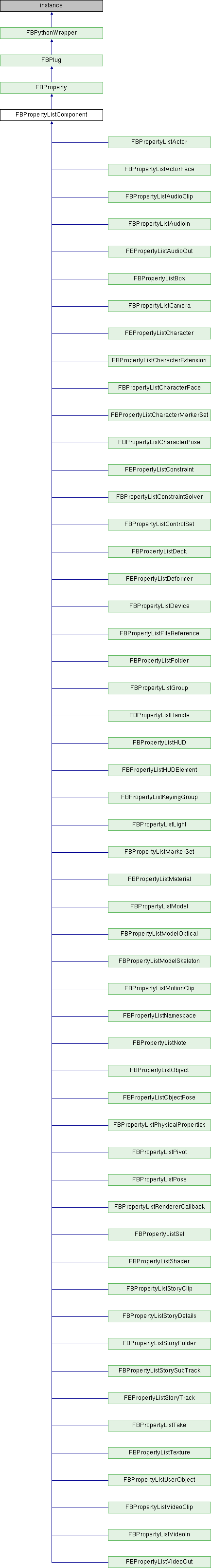

+ Inheritance diagram for FBPropertyListComponent:
