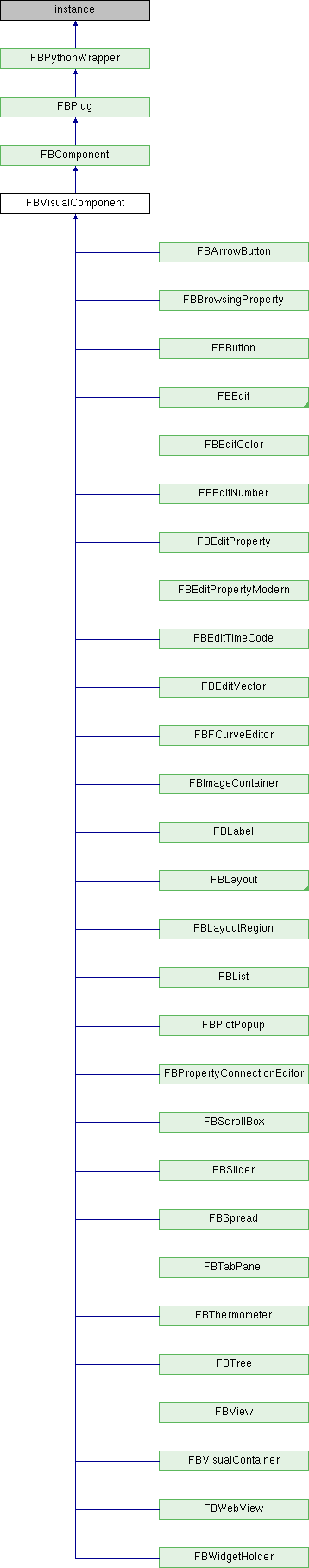

Related help topics: #include <mobu-python-api.h>
Visual Component base class.
All of the user interface elements available in the SDK derive from this class.
Inheritance diagram for FBVisualComponent:Public Member Functions | |
