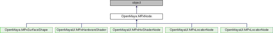

Base class for user defined dependency nodes.
+ Inheritance diagram for OpenMaya.MPxNode:
