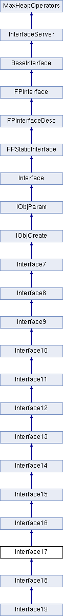

Interface17 Class Reference
#include <maxapi.h>
Class Description
Extends Interface16 Client code should retrieve this interface using GetCOREInterface17.
+ Inheritance diagram for Interface17:
