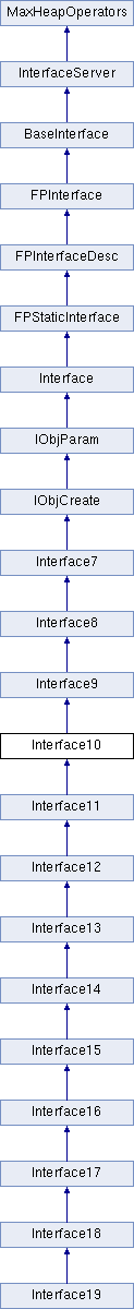

Interface10 Class Reference
#include <maxapi.h>
Class Description
Extends Interface9 Client code should retrieve this interface using GetCOREInterface10.
+ Inheritance diagram for Interface10:
